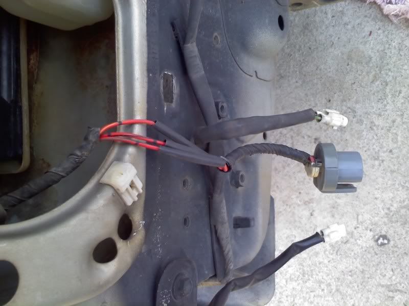

    here are some close ups of how I bolted the 4runner head lights.

  13. toy_spd
    toy_spd Addict
    Dec 29, 2006
    607
    So.Cal -
    92 SR5 V6 Extra Cab
    1st I just zip tied the head lights on, then I installed the grill.
    After that I centered the lights and grill, once everything was in order and had a nice gap, I used self taping screws to hold the head lights. 4 screws per head light.
    Then I just went back and re-drilled the screw holes, got nuts and bolts from my Toyota bolt bin and bolted them right up. I used a rubber spacer for the 2 bottom brackets. You have to have the factory bracket in order for this to work. The last picture shows the factory bracket.
    And that's it.
    Corner markers require the stud removal and trimming of the bottom portion of a vent so you wont have a huge gap.
    Bumper is straight bolt on.
    I used the electrical pig tails for the head lights and for the bumper lights so everything is factory sealed.

    yeah its comes on the 4runners and is bolted to the lower tab on the head lights, if you go to the pick a part when you pull them off, they are right there on the truck, instead of removing the lower tab, just unbolt the bracket and leave it attached to the lower tab.
