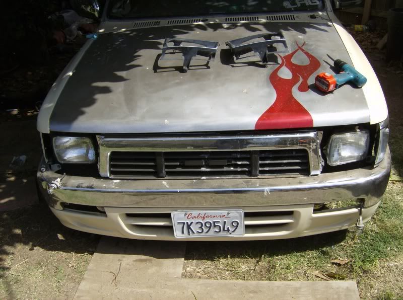

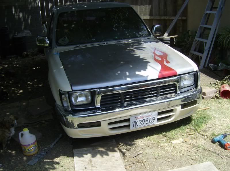

    So yesterday I picked up a 4runner front bumper. When I put it on I didnt quite like the way it fit. The Driver side end sticks out a little bit and the passenger is alot. Is there a trick to installing these. I would like it to sit realatively flush with the fenders (2wd and I would like to keep those).

    The driver side looks right. The passenger side actually looks bent. It does stick out like that. Here is a picture to show even though it isnt the greatest.

    Yeah from your picture it looks as if the passenger side is bowed out.
    Also it looks like you have 2WD fenders. That could be the reason it is sticking out further than you want. All the 4runner bumpers are made for 4WD fenders. That would help the driver side for sure but the passenger still looks bent.

    Well thats what you get for not getting those lights from me. J/K man Ya it does look bent to me to. 2wd fenders will have alittle to do with it but not that much. Here is mine.

    Definatly no 4runner grille. I love the look of the2wd front, I may just say f it and put my dented 2wd back on. The bumper itself looks straight but the brackets are Little tweaked

    The 4runner bumper should stick out a bit equally on both sides since 4runner/4wd fenders are meant to line up with the bumper.
    1. Is it possible that your truck (prerunner days) took a hit and now the front frame horns are a bit crooked?
    2. Maybe the bumper brackets a bit bent out of shape?
    Try loosening up the bolts on the bumper AND the bumper brackets. There is definitely a lot of forgiving play there.

    Well I took everything off and it looks like one of the brackets is bent. So im going to fix that one and see where ot leads me.
