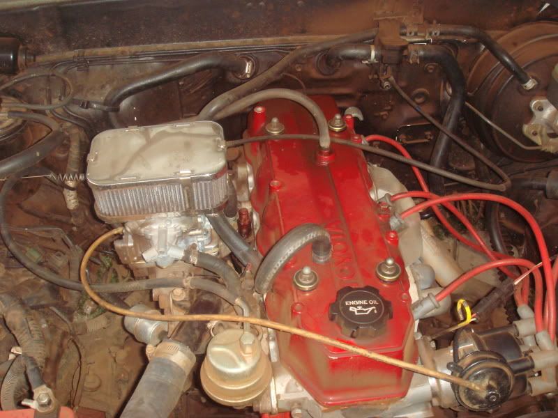

    Nook, your my best friend...we think a lot alike. I too have never used a regulator or even an aftermarket fuel pump on any downdraft weber. Here is an old pic of my 4x4 setup
    Mechanical fuel pump outlet straight to weber inlet...no problems with this setup

    Some of the mechanical pumps have two, some have three. Doesn't matter, just as long as one's going to the carb inlet, and the other is going back to the tank

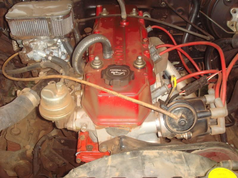

    so the next question is, is there an electric pump in my tank? i just looked before i left for work and it looked like there was only one wire going to the tank, and i assume thats for the fuel sender..
    ****ty pic of my 22r.. notice the highrise on the weber :clapping: buddy traded me it cause it wouldnt fit right on his motor :runaway: thanks joe!:waytogo:

    No, there is no electric pump in your tank. When looking at the picture, you can see that there is a mechanical fuel pump on the intake side of the engine. Its that round copper looking item at the very front of the cylinder head. Electric fuel pumps were usually on EFI equipped models.
    Nice high rise. I had one of those on my 4x4, didn't notice any difference in gains though.
