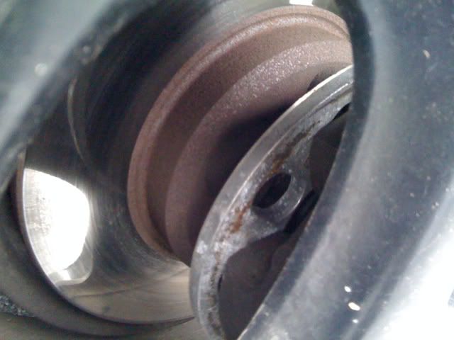

    I used 1/4" spacers to clear the center bore but I will open up the holes to take those back out. Rears fit without any mods. The front tires are taller than what I was running, by almost an inch. I used to have this same size on the Probe rims. They rubbed the top of the inners quite a bit, so I pulled into a parking lot and put in some small single bolt bump stops I had. It pretty much sits on them. I will probably have to finally cut and raise the inner fenders. I will probably do it with rivets and panel glue since I don't have a welder. If I have to do it, I'll make it so I can lay out the crossmember on 25" tall tires. For in case I bag it down the road. Which I would like to. Atleast the front.
    Anyways, enjoy the pics. I'll keep playing around with how the front sits and camber and stuff til its where I like it.
