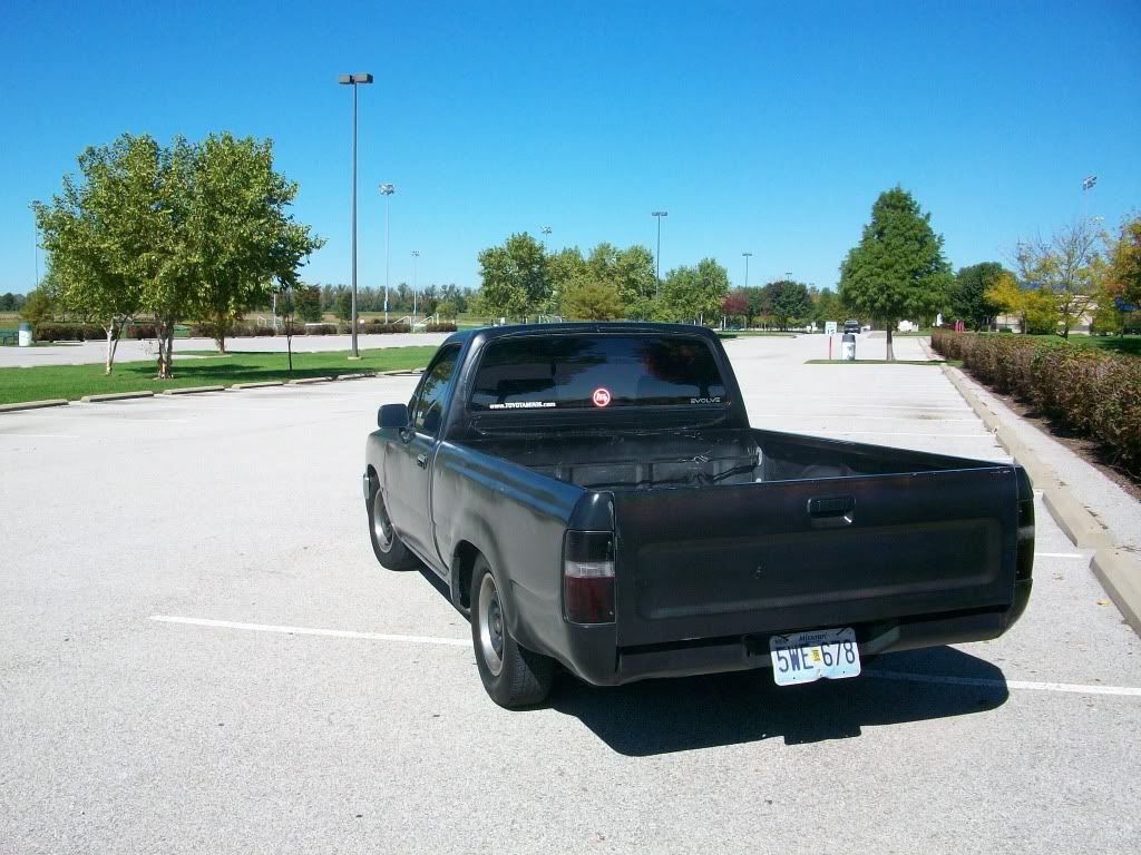

    heres how mine turned out
    its weird cuz i never really used my sliders before and now that i have a one piece and cant open my back window i always want too. lol

    Looks good. Im wanting to go with a 1 piece so I can have a big sticker cover the entire window to advertise for MyJZswap.com
