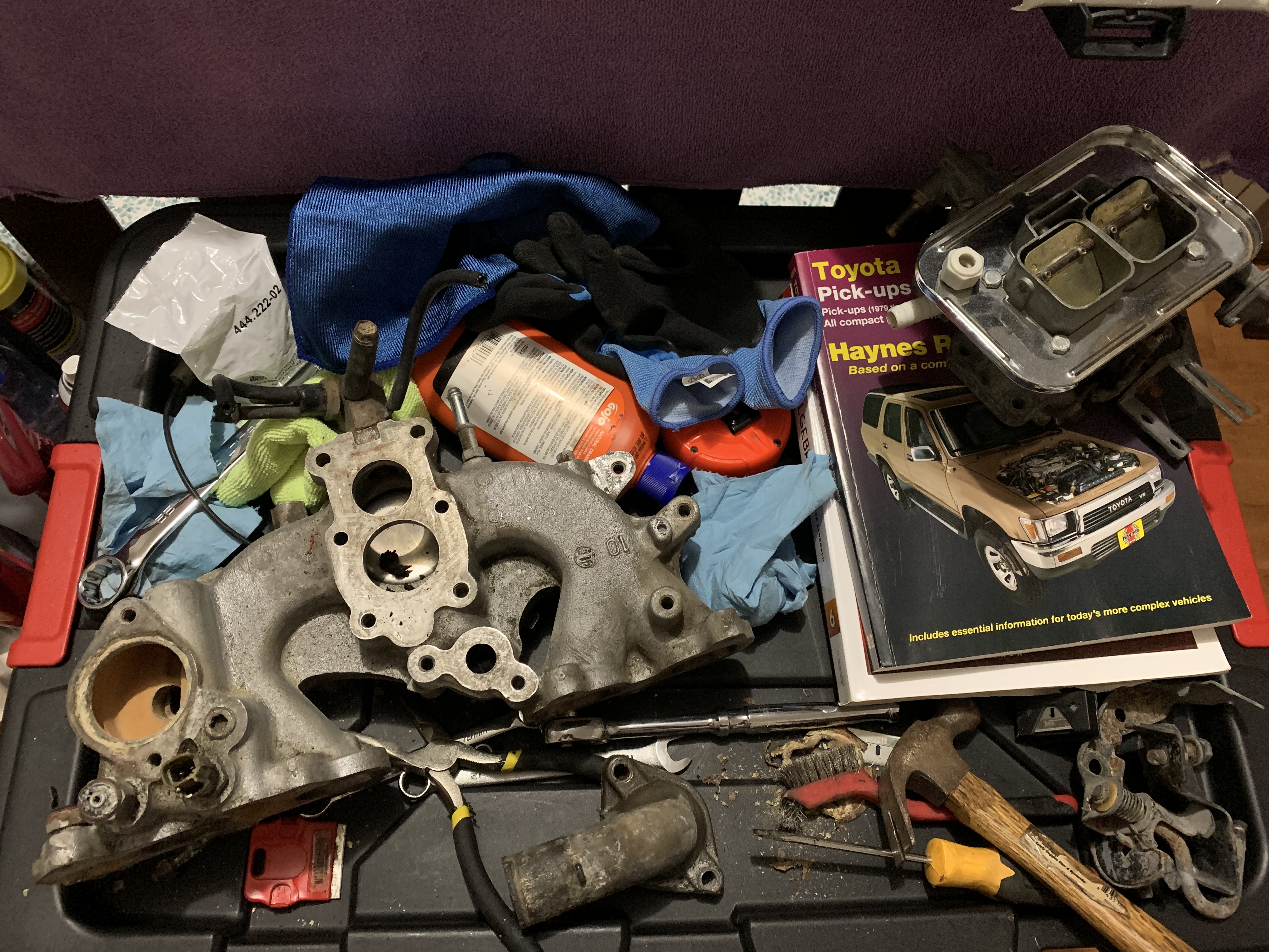

      Backstory: Opened up the intake manifold found out there was no thermostat. Installed it 12 o clock if I remember. Installed my egr plates and a home made water block off plate that I will show soon.
      Installed the 32/36
      will go weber 38 later on...
      Pretty interesting how the coolant flows through the manifold to the head. When I was wiggling the manifold off some back splash when into the intake ports. Its fine.
