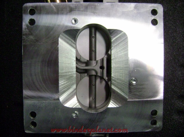

    I suppose you'll have some giant adapter plate like this?

    Well the Holley is a 4bbl intake. I can find an adapter for that one. It is a common enough swap ( for v8's going from carb to TBI) if I use the cannon intake I'm going to have to make an adapter going from Weber to TBI. either way the adapter is gonna be around 1/4-5/16". I talk to another guy who has done this setup, he said there wasn't much of an issue with hood clearance and I can find a low pro air filter if I have to.
