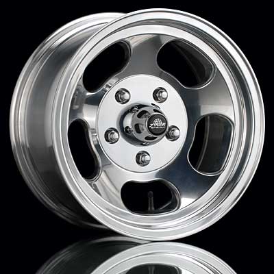

    Will these wheels fit?
    The only thing I don't know is if the center bore diameter will work
    Ansen Sprint Slot Mag 15x7 5/4.5
    Backspacing (in) 4.000 in.
    Beadlock Functional No
    Beadlock Included No
    Center Cap Included Yes
    Hub Centric Yes
    Load Rating (lbs) 1,600 lbs.
    Lug Nut Seat Style Conical seat - 60 degree
    Offset (mm) 0.00mm
    Quantity Sold individually.
    Recommended Valve Stem 7/16 in. pull-through or bolt-on
    Rim Diameter (in) 15 in.
    Rim Width (in) 7.00 in.
    Valve Stems Included No
    Wheel Construction 1-piece
    Wheel Finish Natural
    Wheel Material Aluminum
