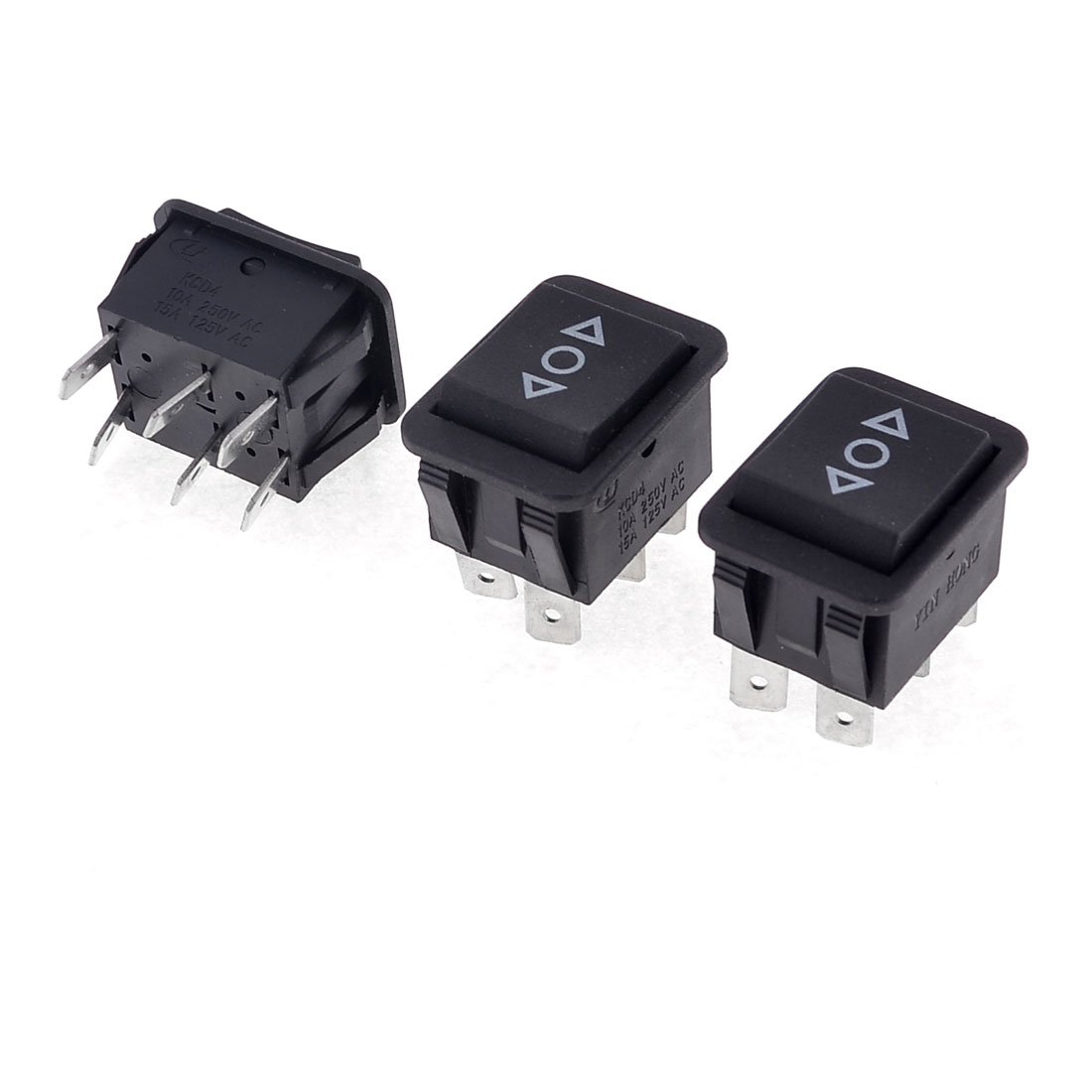

    In this case I figured all you would need is a six pin momentary rocker switch to do what you need. I wrote up a very crude diagram on how this would work:
    Here are six pin momentary rocker switches in real life:
    No relays needed. In theory that should work.
