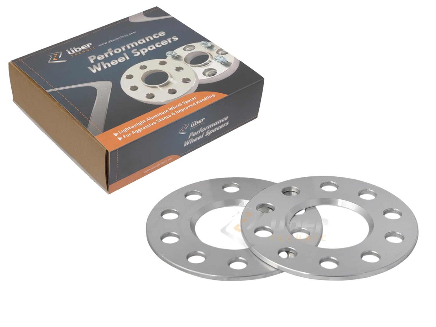

    5mm spacer in the rear should do the trick.

    Just ordered (2) 5mm spacers with 67.1mm hub bore same as my hub rings. Im going to mount a tire and try the spacers out. I really like the rims and would love to see them work. Any suggestions on tire size? Should I run the same 205/40/16's i have on my 16x8's?
